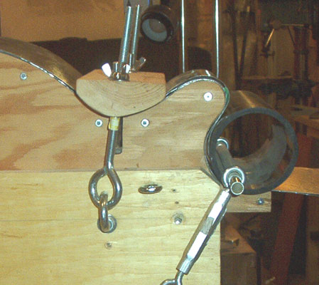

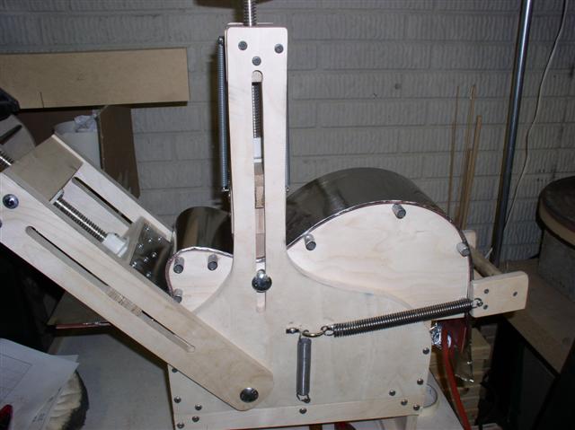

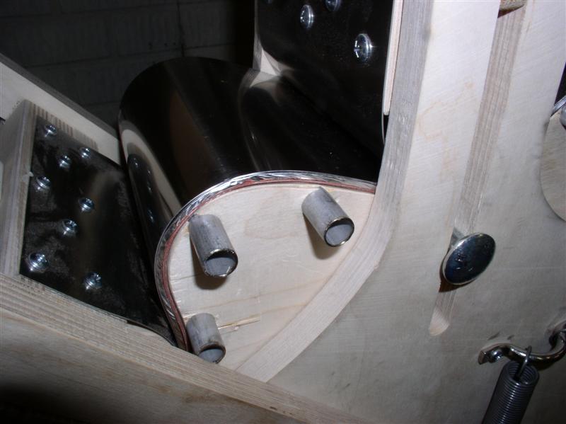

I have been struggling with bending highly figured wood into cutaways without cracking the sides in the curl. So after watching the Taylor bending videos, I decided that the biggest problem is keeping the sandwhich pressed tightly against the form especially on the outside bend. I decided to incorporate some tension on the slats using swing arms and springs. This does not seem to be working as well as I had hoped. Now I know that many people bend cutaways regularly and I am wondering if maybe it was not just my technique. I had been using a simple fox style bender with a standard cutaway attachment and although I have bent them myself I am really struggling with curly wood and it is too expensive to continue my current record. Maybe someone can give me a clue or some ideas for improving my new bender. Here is a picture of the new setup.

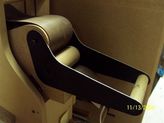

John, I saw this one somewhere and thought it looked like it would work pretty well.

Paul, in operating my bending jig, I bwnd the waist first using the screw and then attach the the slats to the arms via the springs and bring them up to tension. Then I draw the lower bout down and secure the arm with a strap. Then I bring the upper bout down until the horn is formed. After that I secure the outer form block in place with overcenter latches and then bring the swing arm back up to horizontal and secure with the post you see in the picture. The trouble is I'm still getting crack at the horn and I'm guessing it's because of insufficient pressure. I may try some stronger springs. It's only the real strong curl that give me trouble but my cutaway bend is not that radical really.
Dave, that looks very interesting if it could be make adjustable for different shapes, and it loooks like it could.

Dave--I installed the pivoting cutaway bender shown above about a year or so ago. My theory is that it gives a more tactile feel when bending similar to hand bending. The 2" diameter caul is free to rotate during the bending.
I still fracture highly figured maple occasionally but nothing like previously. I'm wondering now, after reading Sylvan's post, whether some or all of it is occuring during removal. Thanks for the heads-up, Sylvan.

Paul, I am working from the waist out. Waist first then lower bout then the horn and finally I bring the swing arm back up to form the inside bend of the cutaway. When all is clamped and I look between the slats everything seems fine and I don't see anything that looks like a crack. Usually you can tell before you unwrap if there is a crack so maybe Sylvan is right and I'm cracking it as I remove it. I'll try to pay a little closer attention to how I get it out of the bender.
Nelson, originally I was thinking of making a bender sort of lying flat on the table like th Tacoma pics there but after viewing the Taylor video, came up with this current design.

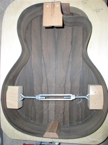

I managed to complete this soloist style venetian bend yesterday... aside from two small tear outs which I c.a. glued shut, the side came out ok.
I was going to make this guitar a full body OM for fear of breaking my last set of this sapele, but at the last minute decided to go for it.
I bent the side free hand on the hot pipe, as I have not mastered the fox bender method yet.
I did`nt get the curves as tight as I might have with the bender, but I think I like this shape as it gives some room for my upper face brace to go all the way out the side.
I`ll most likely be a free hand guy for a while.

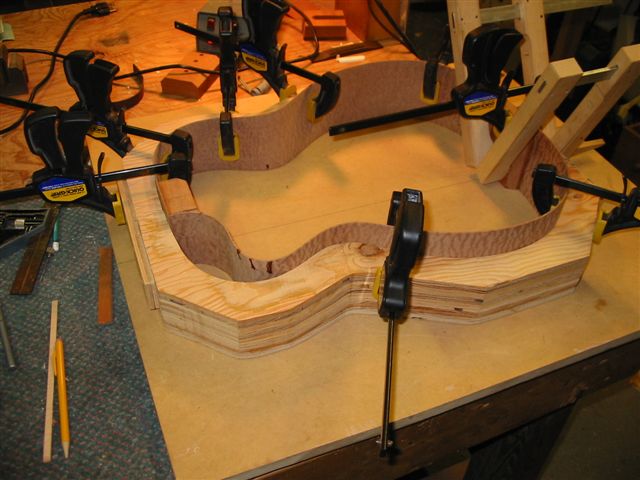

Here is mine - its a Blues Creek set up. I really like the waist cull that John has come up with.
And here is the result.
LanceK38675.341412037
